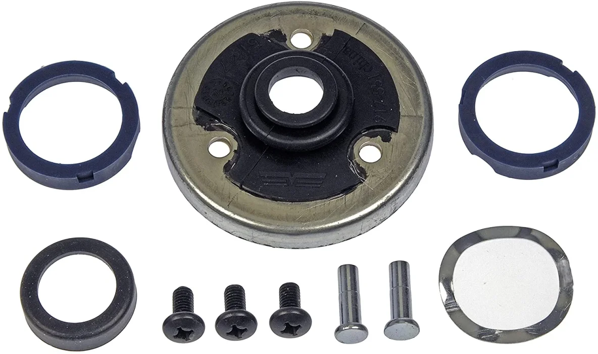

1998 Ranger xlt 2 dr extended cab 2.5 5 speed The shift is very loose, shifting between 2nd and 3rd long side movement same going to 5th is there anyway of adjusting the throw between gears. Never had one like this before. Any idea's On another issue the power steering pump is noisy loud at time's..Would adding Auto transmission "Shudder Stop" to the fluid help or would it be BAD idea, any thought's on this??
