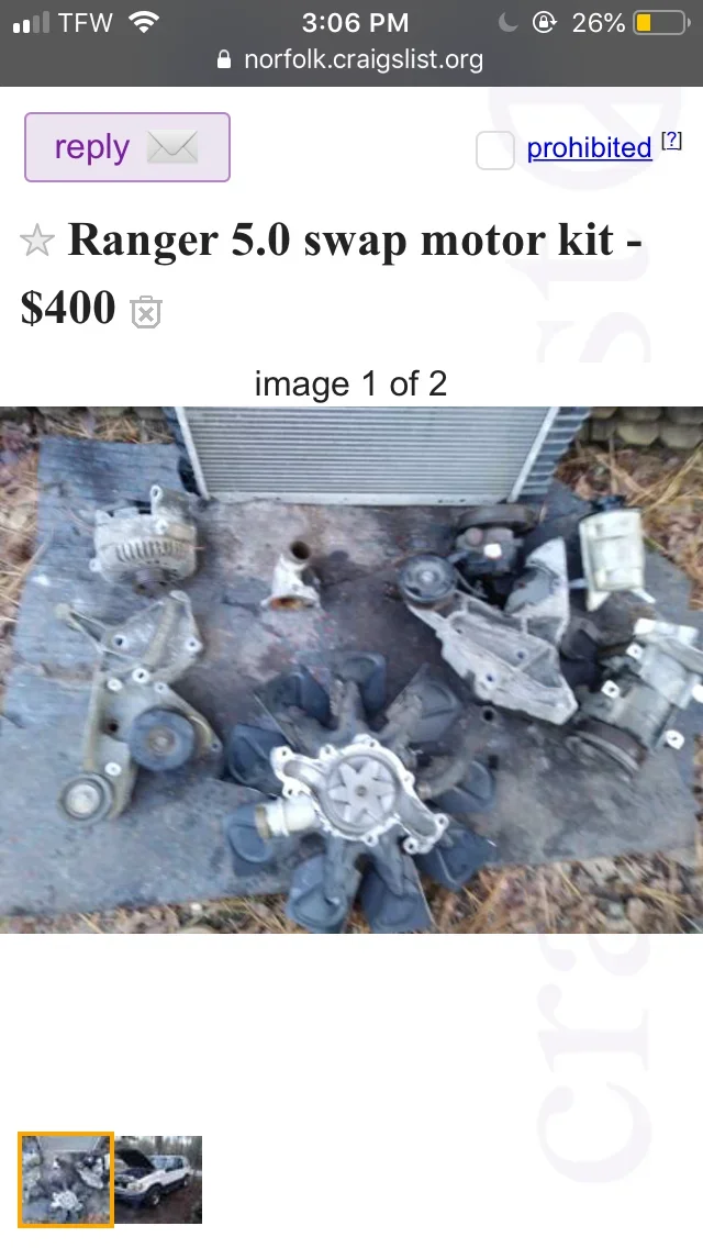

Find a ford explorer 5.0 same year and the motor mounts go right in find you a 5.0 and have some fun.
