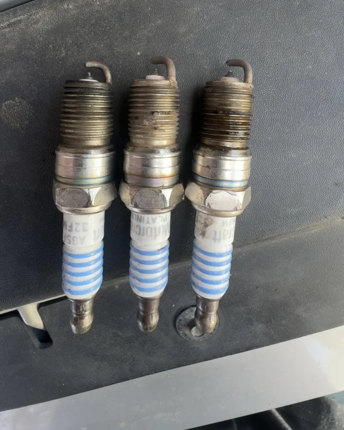

Figured it out, for anyone wondering in the future…
Pulled cylinder 1, 2, and 4 spark plugs. Insulator was, inexplicably, not the same distance from the end of the threads. Swapped cylinder 1 with 4, misfire moved to cylinder 4, got a new plug, misfire gone. These were brand new motorcraft plugs a few weeks ago, but I didn’t notice the manufacturing defect. And no, the ground electrode was not bent in and the gap was roughly the same. And yes, the part numbers on the plugs were identicalIMG_6050.webp
