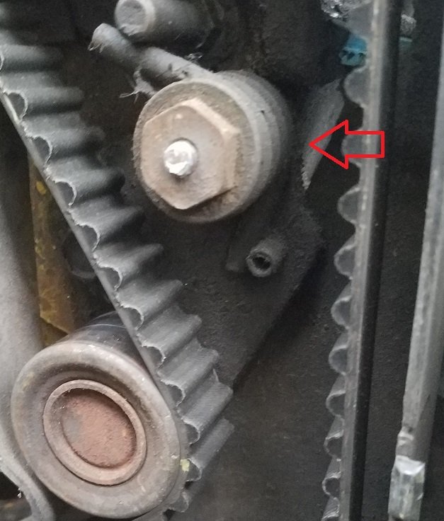

    Hi All. I'm no pro. I am learning as I go. I need to replace the timing belt tensioner pulley on my 93 Ranger 2.3L. I have everything off and I am trying to release the tension on the spring so i can get the belt off. I have not been successful. Everyone talks about how easy it is to take off the belt, so I'm certain I'm missing something basic. I saw a Youtube where a guy made a tool out of a pipe to do this. I asked about a tool at the autoparts store but they have no idea what I'm talking about. Any advice would be appreciated. Image of tensioner spring attached.

    found this. Gonna give it a try. Any comments still appreciated. Found this tool $20. (they wont let me post the link yet.) Gonna give it a try. Any comments still appreciated.

    When I replaced the water pump on my splash, all I did was use a socket and a breaker bar. A standard ratchet, not 1/4 but 3/8 or 1/2 inch will also do.

    Thanks Zappy, thats what I ended up doing to get it off there. I couldnt get quite enough range of pull to release the tension the first few times i tried, but after some ozarks engineering i got it off. I did get that tool though, and it works great. I had to replace the tensioner spring bolt to use it, because the previous owner broke a bolt off inside the threaded portion of the original one.

    Yeah, the real fun is putting the belt back on. I get the belt on there, then had to put the ratchet on the tensioner, swing the ratchet over and hold the tensioner while I quickly return the ratchet to finish getting it up enough to put the belt under it.

    Thats where that tool comes in super handy! Attach the tool to the spring bolt and rotate the tensioner with a ratchet and the belt drops right on. You can see in the pic i uploaded previously that my spring bolt has a screw broken off in the threaded center hole where the tool screws on so i couldn't use the tool to take it off. But putting it back i replaced that bolt. It was worth the $20 cost of the tool just for that.
