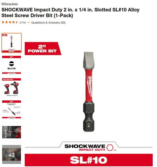

    I then thought, why don't I get a long screw driver bit, put it in the hole, and then turn the bit to either open or close the door. Then run the A/C for a few minutes to see which way I turned it (cold or hot). Finally, plug in the new actuator, and adjust the temp control to match how the door is. I figured it would line up and snap right into the hole after doing that. But even after doing all that, I couldn't get the new actuator to go into the hole on the blend door.
    I then thought, Forget the actuator; I'll just leave the screw driver bit in the hole, and turn it as needed. All I need is a 1/4" socket and a small ratchet in my glove box to use any time I need to adjust the temp.
    See attached picture for the screw driver bit you need for this.

    Update: The blend door moves freely; it won't stay in place after I move it to the desired position. I need to come up with a way to hold it in place while the A/C is running and while the car is moving down the road.
