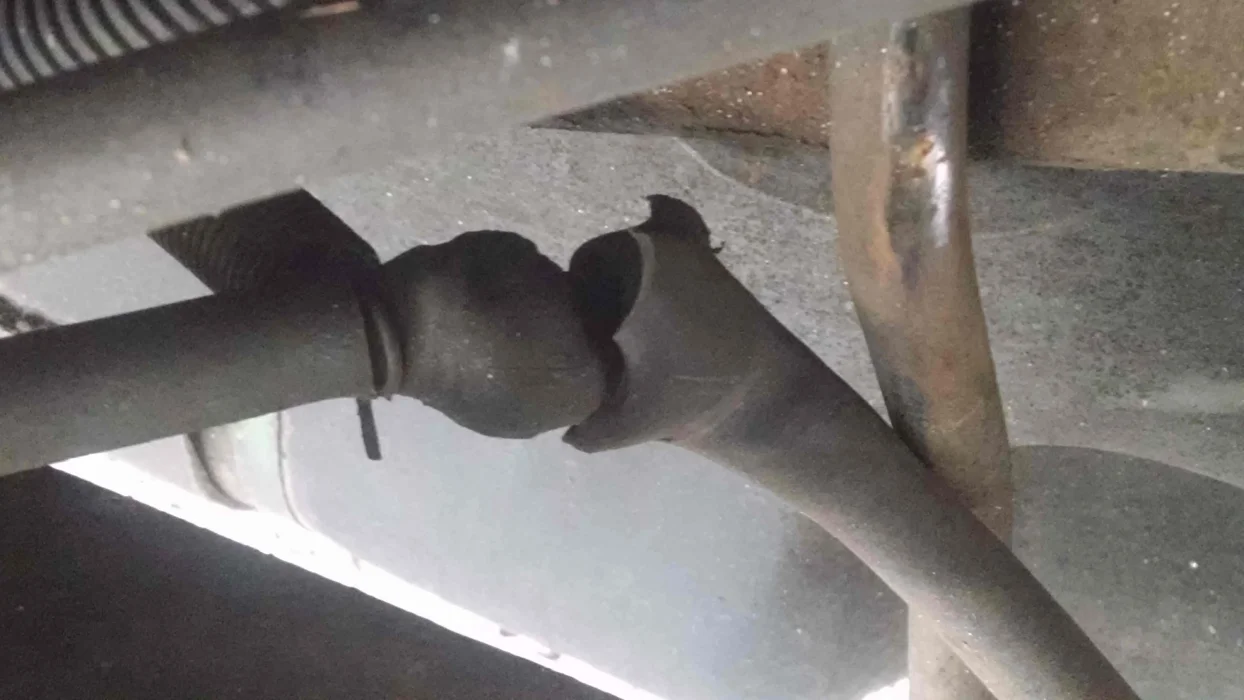

    Also discovered a busted emergency brake line ... Causes delay in releasing emergency brake ... But still works. Right passenger side ok, but left branch sticking on first release in the morning.
    Getting it repaired next afternoon at Ford's QuickLane shop for $140 parts & labor. Sound reasonable?

  9. mhoward
    $140 sounds about right for the repair at a dealer. And 220K is still pretty impressive mileage.
